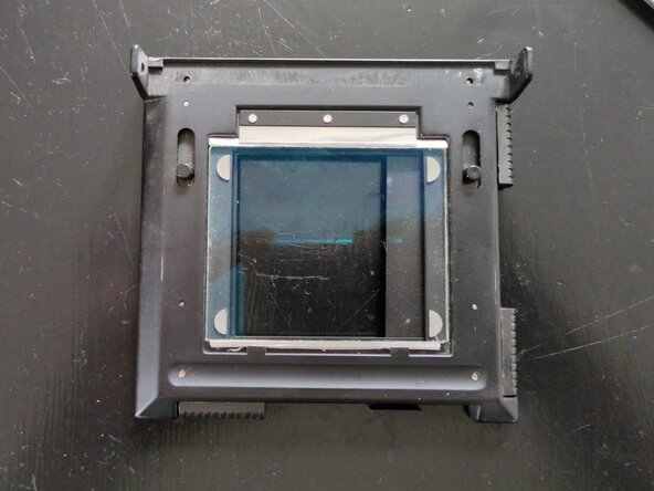

    • Dissemble the negative carrier by unscrewing it at the hinge
    • Select one part of the negative carrier to work on. Store the other one in a secure location
    • The image of the lower half of the carrier shows the already replaced glasses. I'll try to supply better photos for documentation

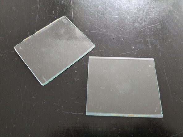

  2. Miscellaneous Electronics Durst Sironeg glass inserts Replacement, Remove glass from carrier: adım 2, 2 resimden 1. Miscellaneous Electronics Durst Sironeg glass inserts Replacement, Remove glass from carrier: adım 2, 2 resimden 2.
    • Make sure to wear gloves for cut protection and to keep the glasses clean
    • Hold one half of the negative carrier in you non-dominant hand
    • With the other hand firmly grab the glass from both sides
    • Slightly push the glass towards to sheet metal flap on the side of the negative carrier hinge
    • Allow the glass to tilt upwards at the side opposite to the hinge
    • Repeat for the second half of the negative carrier

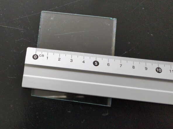

    • Use a ruler to measure glasses
    • Note that the glasses are beveled along the long edges. This is how the are secured in the negative holder
    • Take the following measurements:
    • Total size of the glasses. In my case: 75 x 65 mm
    • Size of the glasses without the bevels. In my case: 75 x 60 mm
    • Procure the needed glases
    • If you can get beveled glasses, get the measured total size
    • If you can only get even edges, get the smaller measured size
    • You can also cut the glasses from a bigger sheet of glass.
    • Use the appropriate PSA when cutting glas!
    • Instructions can be found here
