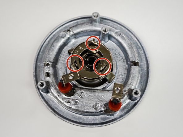

  8. Oster DuraCeramic  Titanium Infused 6-Cup Rice and Grain Cooker with Steamer Disassembly, Thermomagnet: adım 8, 2 resimden 1. Oster DuraCeramic  Titanium Infused 6-Cup Rice and Grain Cooker with Steamer Disassembly, Thermomagnet: adım 8, 2 resimden 2.
    • Bend the three tabs flat.
    • Remove the thermomagnet assembly from the heating coil.
