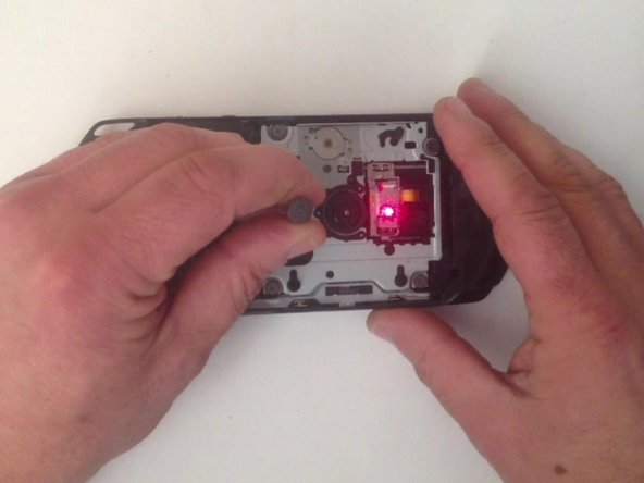

    • If you haven't indication for inserted disk the problem probably is in UMD switch.

    • With a screwdriver I short the UMD switch to test the laser.

Step 2 - picture number 3 is wrong, I broke off a little part of my PSP E1004. The left arrow points up but you have to pull it down, while trying to pry gently to the right. I learned the hard way after I managed to take it off.
