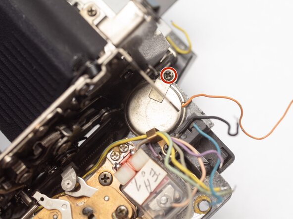

    9. Pentax Super Program Mirror Box Mechanism Service, Remove main PCB: adım 27, 1 resimden 1.
      • Gently lift away the PCB from the mirror box.
      • The TTL flash metering cell needs to be unseated from the side of the mirror box to free the PCB for removal.

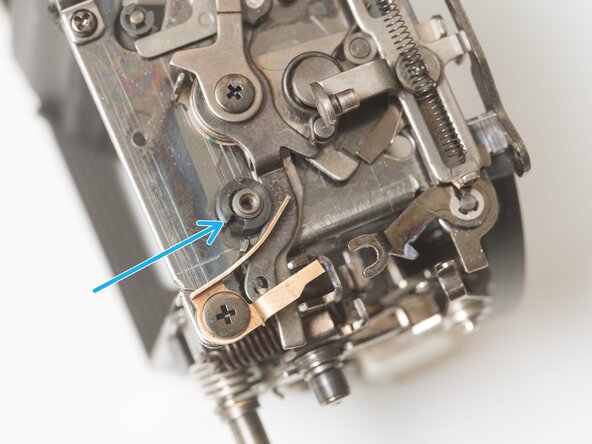

    1. Pentax Super Program Mirror Box Mechanism Service, Remove mirror return latch: adım 34, 3 resimden 1. Pentax Super Program Mirror Box Mechanism Service, Remove mirror return latch: adım 34, 3 resimden 2. Pentax Super Program Mirror Box Mechanism Service, Remove mirror return latch: adım 34, 3 resimden 3.
      • Remove one M1.3 x 2.1 mm shoulder screw.
      • Remove one M1.3 x 2.4 mm screw.
      • Remove coil spring.
      • Remove one shim washer.
      • Note the rubber bumper on the pivot post. This should be removed and cleaned before reassembly.

      • Remove aperture stop-down lever.
      • Remove shim washer.
      • Installation Notes: Ensure the lever foot is placed properly between the mirror flip-up spring and the mirror return lever during reassembly.

    7. Pentax Super Program Mirror Box Mechanism Service, Clean mirror box components: adım 40, 1 resimden 1.
      • Remove two old rubber bumpers.
      • Clean all pivots with isopropyl alcohol.
      • Clean all removed components with isopropyl alcohol.
      FixBot'a Sor
      Yorum Ekle
    8. Pentax Super Program Mirror Box Mechanism Service, Reassembly Notes: adım 41, 1 resimden 1.
      • The mirror mechanism does not need lubrication to operate properly. Most moving interfaces run dry.
      • High friction latching points can be lubricated with a heavy moly grease to reduce wear.
      • Replacement rubber dampers are optional. Silicone tubing cut to length is good source.
