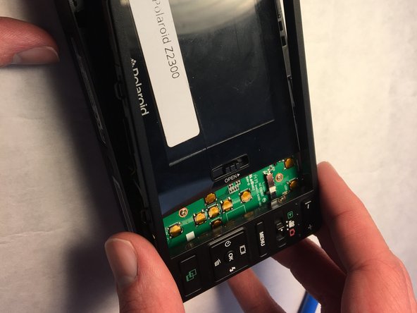

    • Locate and remove the two 2.5 mm long screws on the bottom of the camera.
    • Screw head: JIS J00
    • The screws are very small, be careful not to strip or lose them!
  2. Polaroid Z2300 Control Panel Replacement: adım 2, 3 resimden 1. Polaroid Z2300 Control Panel Replacement: adım 2, 3 resimden 2. Polaroid Z2300 Control Panel Replacement: adım 2, 3 resimden 3.
    • Once the two screws are removed, flip the camera to back side up.
    • Use a plastic opening tool to disengage the outer plastic trim until it can be safely removed.
  3. Polaroid Z2300 Control Panel Replacement: adım 3, 2 resimden 1. Polaroid Z2300 Control Panel Replacement: adım 3, 2 resimden 2.
    • Use a plastic opening tool to pop the control panel off, it should be easy to lift up and remove.
