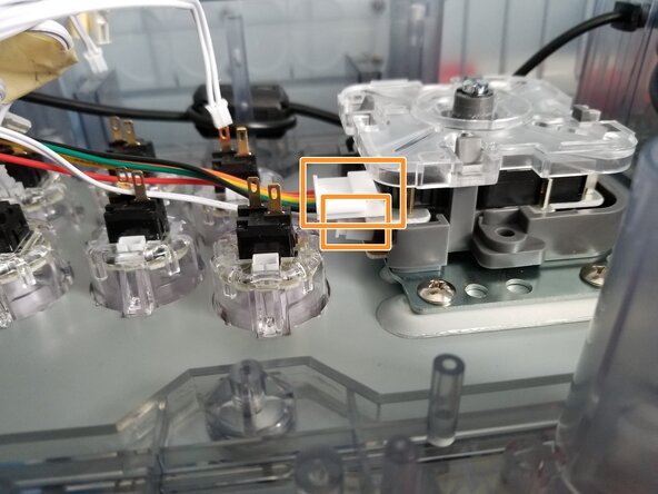

    • Taking a picture or marking cables with masking tape is advised as it will help with the reassembly process.
    • Each button has three cables, unplug these from each one.
    • The joystick has two cables, unplug both of these.
    • The use of ESD safe tweezers may assist with unplugging the cables.
