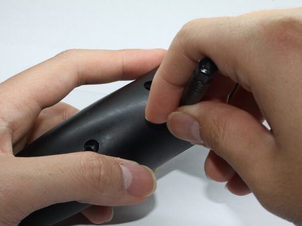

    • Use the pointed end of a spudger to remove the three rubber ends that cover three screws.

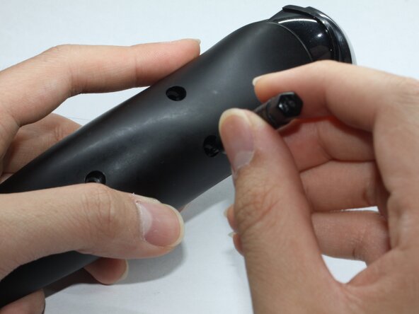

  2. Razer Hydra Joystick Cover Replacement: adım 2, 3 resimden 1. Razer Hydra Joystick Cover Replacement: adım 2, 3 resimden 2. Razer Hydra Joystick Cover Replacement: adım 2, 3 resimden 3.
    • Use a Phillips screwdriver to remove the three screws.

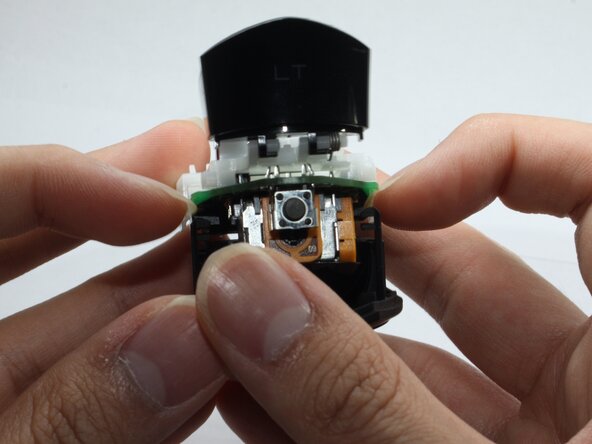

  3. Razer Hydra Joystick Cover Replacement: adım 3, 2 resimden 1. Razer Hydra Joystick Cover Replacement: adım 3, 2 resimden 2.
    • Hold onto the bottom of the controller, and slide the top shell off.

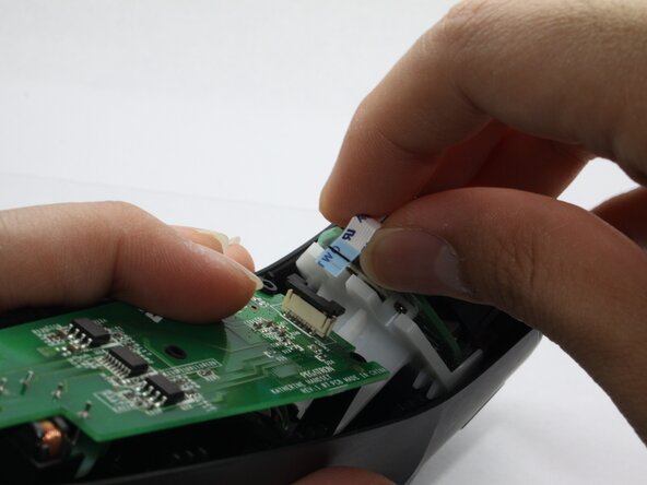

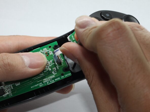

    • Slowly pull up the black locking tab connector attached to the ribbon cable.
    • BE CAREFUL! This black piece does not come off. Only lift it so that it is not holding the ribbon cable.
  5. Razer Hydra Joystick Cover Replacement: adım 5, 2 resimden 1. Razer Hydra Joystick Cover Replacement: adım 5, 2 resimden 2.
    • Separate the ribbon cable from the housing.

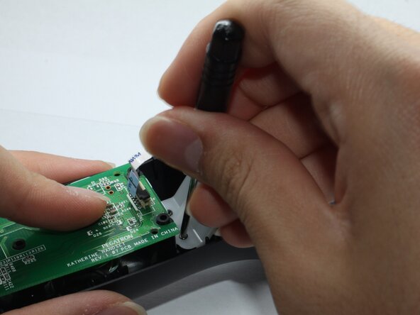

  6. Razer Hydra Joystick Cover Replacement: adım 6, 3 resimden 1. Razer Hydra Joystick Cover Replacement: adım 6, 3 resimden 2. Razer Hydra Joystick Cover Replacement: adım 6, 3 resimden 3.
    • Use a Phillips screwdriver to remove the two screws securing the joystick PCB to the case.

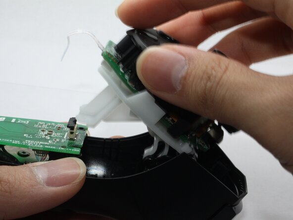

  7. Razer Hydra Joystick Cover Replacement: adım 7, 2 resimden 1. Razer Hydra Joystick Cover Replacement: adım 7, 2 resimden 2.
    • Gently remove the joystick board.
