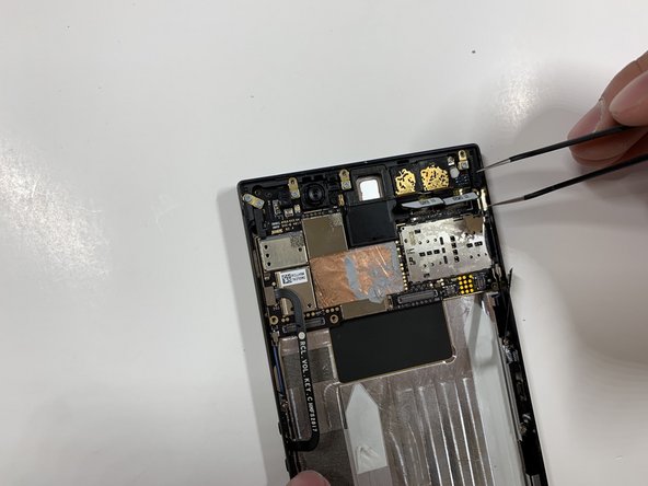

    • Grab the connectors with the tweezers and gently lift the connectors loose.

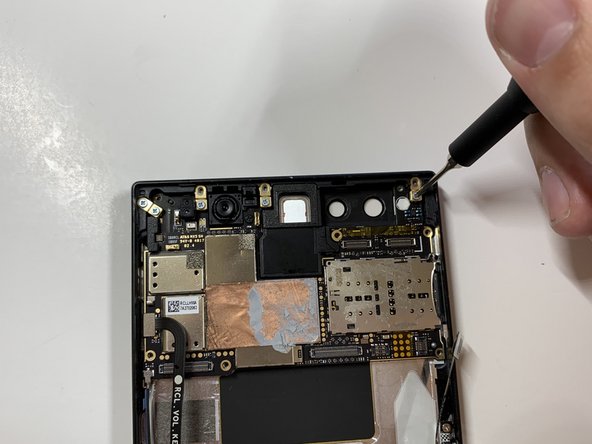

    • Remove the one 2.5 mm screw with the Phillips #000 screwdriver.
  17. Razer Phone Motherboard Replacement: adım 17, 1 resimden 1.
    • Remove the one 2.5 mm screw underneath the connectors with the Phillips #000 screwdriver.

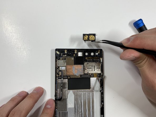

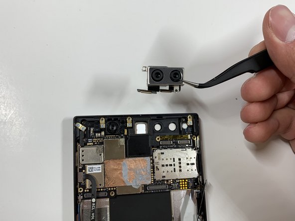

    • Grab the loose connectors with a tweezer and gently remove the rear camera unit from the phone.

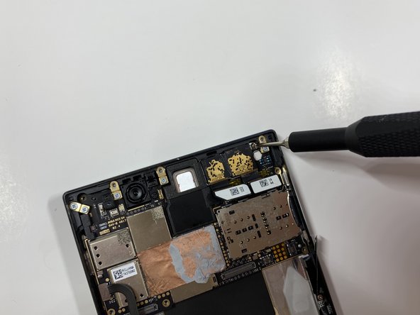

    • Remove the five 1 mm screws holding down the gold antenna line brackets to the motherboard using the Phillips #000 screwdriver.
  21. Razer Phone Motherboard Replacement: adım 21, 2 resimden 1. Razer Phone Motherboard Replacement: adım 21, 2 resimden 2.

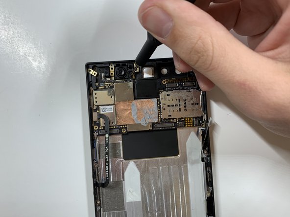

    • Remove the 2.5 mm screw next to the front-facing camera with the Phillips #000 screwdriver.
  22. Razer Phone Motherboard Replacement: adım 22, 2 resimden 1. Razer Phone Motherboard Replacement: adım 22, 2 resimden 2.
    • Remove the four gold antenna line brackets with the tweezers.

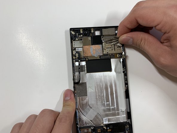

  23. Razer Phone Motherboard Replacement: adım 23, 1 resimden 1.
    • Using the tweezers remove the SIM card tray from the body of the phone.
  24. Razer Phone Motherboard Replacement: adım 24, 1 resimden 1.

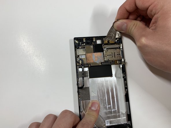

    • Carefully lift up the motherboard away from the device.
