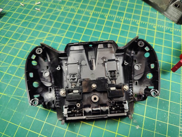

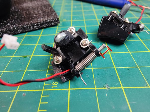

  4. Razer Wildcat Xbox One Controller Disassembly, Remove the triggers: adım 4, 3 resimden 1. Razer Wildcat Xbox One Controller Disassembly, Remove the triggers: adım 4, 3 resimden 2. Razer Wildcat Xbox One Controller Disassembly, Remove the triggers: adım 4, 3 resimden 3.
    • Remove the two PH #00 screws to remove the trigger brackets
    • Slide the trigger pin out just enough to remove it, leave the spring attached
    • The three remaining screws on each trigger are PH #1
