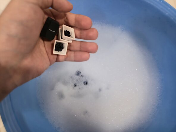

  4. Refurbishing Computer Keyboard, Put the keycaps in the bowl: adım 4, 1 resimden 1.
    • Grab all of the keycaps and dump them into the bowl containing the soap water. Leave the keycaps in there for a while, up to 2 hours. Also, you can mix the keycaps in the bowl with your hands as well if you'd like to.
