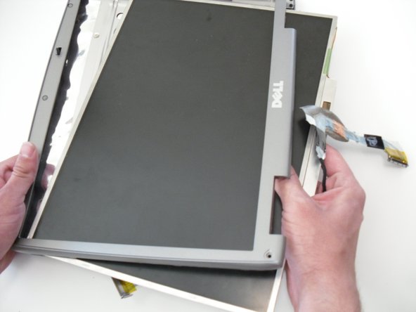

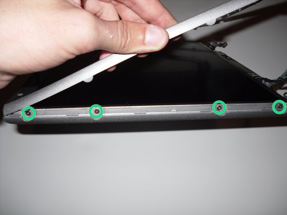

  8. Removing Dell Inspiron 1150 LCD from Display Assembly, Removing LCD from Display Assembly: adım 8, 3 resimden 1. Removing Dell Inspiron 1150 LCD from Display Assembly, Removing LCD from Display Assembly: adım 8, 3 resimden 2. Removing Dell Inspiron 1150 LCD from Display Assembly, Removing LCD from Display Assembly: adım 8, 3 resimden 3.
    • Remove the 2 screw covers and 3 rubber bumpers to reveal 5ea M2.5 x 5mm Philips screws
    • Remove the 5 screws and gently lift off the screen bezel (surround) to reveal the LCD panel and mounting screws which are along each side of the LCD
    • Remove 8ea M2 x 3mm (4 screws along each side)
    • The LCD display can now be removed from the top cover of the laptop
    • The inverter PCB is located on the bottom edge of the LCD display panel and is easily removed
