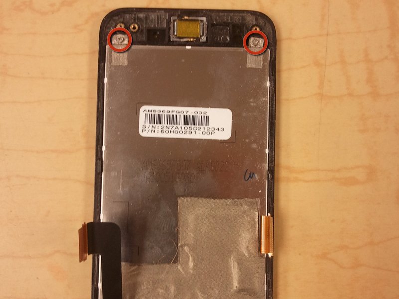

    1. Repairing HTC Droid Incredible LCD, LCD: adım 9, 2 resimden 1. Repairing HTC Droid Incredible LCD, LCD: adım 9, 2 resimden 2.
      • Remove the two phillips screws from the top of the LCD frame.
      • Use your spudger to pry the LCD out of the frame.
      FixBot'a Sor
