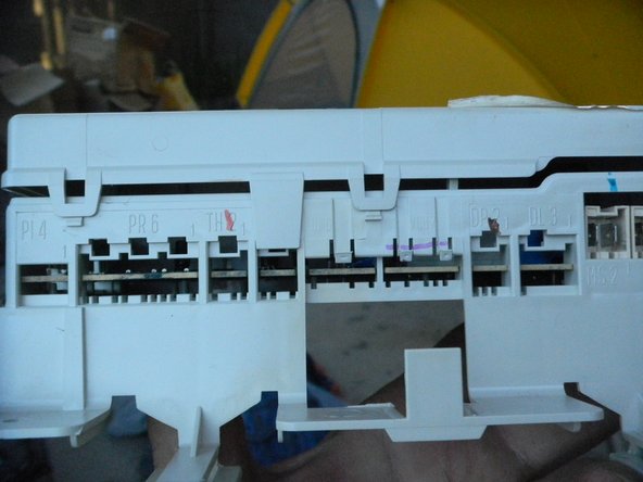

  4. Repairing Kenmore Elite HE3 Washer Control Board Relays, Mark the wires: adım 4, 2 resimden 1. Repairing Kenmore Elite HE3 Washer Control Board Relays, Mark the wires: adım 4, 2 resimden 2.
    • Mark the wires and note how the cables are routed, so you can return them to their original routes after disassembly.
    • Either apply wire labels, or take a fine-tipped permanent marker and as you disconnect each connector mark it with the two letter name of the mating socket, which you will find stamped on the plastic of the control unit's housing. A flashlight will help reading the letters along the left side of the control unit.

"Open the gray housing of the control unit by gently prying the side tabs open." Gently is the operative word here, I broke both tabs, could use a new cover. Found K1 clean as a whistle, no suspect solder joints. Just cleaned the board edge contacts and up and running. We will see how long it lasts.
