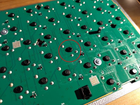

  6. Replace Logitech MX mechanical key, Mark the defective key: adım 6, 2 resimden 1. Replace Logitech MX mechanical key, Mark the defective key: adım 6, 2 resimden 2.
    • To avoid confusion later, mark the defective key. In this case, the “D” key is defective and is marked with a felt-tip pen.
    • Locate and mark the back of the defective key. Each key is connected to the circuit board at three solder points. The black pin is only inserted and not connected to the circuit board.

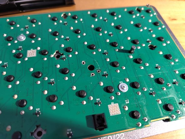

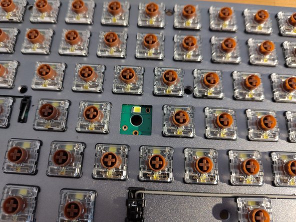

  7. Replace Logitech MX mechanical key, Desoldering key: adım 7, 3 resimden 1. Replace Logitech MX mechanical key, Desoldering key: adım 7, 3 resimden 2. Replace Logitech MX mechanical key, Desoldering key: adım 7, 3 resimden 3.
    • Desolder the three solder joints on the button you marked earlier:
    • Heat the pin until all the existing solder is liquid.
    • Add some fresh solder.
    • Remove the liquid solder with a desoldering pump.
    • After desoldering, you can push the button out from the front.

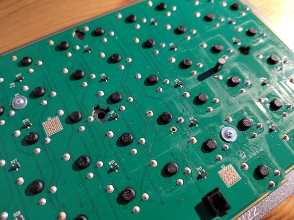

  8. Replace Logitech MX mechanical key, Solder the replacement key: adım 8, 2 resimden 1. Replace Logitech MX mechanical key, Solder the replacement key: adım 8, 2 resimden 2.
    • Insert the replacement key into the gap in the circuit board. It only fits into the gap one way.
    • Re-solder the three solder joints.
