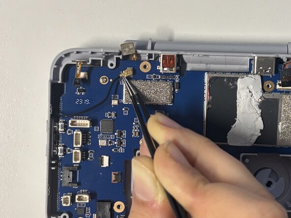

  6. Retroid Pocket Flip Motherboard Replacement, Motherboard: adım 6, 3 resimden 1. Retroid Pocket Flip Motherboard Replacement, Motherboard: adım 6, 3 resimden 2. Retroid Pocket Flip Motherboard Replacement, Motherboard: adım 6, 3 resimden 3.
    • Use a plastic spudger to disconnect the sliding connector by pushing on the tab to slide it out of its socket.
    • Use tweezers to disconnect the ribbon cables from the board.
    • Disconnect the coaxial connector on the left of the motherboard by positioning tweezers under the metal neck of the connector to lift it straight up.
    • Always lift the coaxial connector straight up. Do not pry at an angle, as this can detach the socket from the motherboard.
