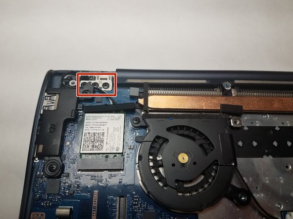

  3. Samsung ATIV Book 9 Plus Screen Replacement, Screen: adım 3, 1 resimden 1.
    • Disconnect the wire connected at the marked location. This is done by giving it a solid tug parallel with the laptop.
