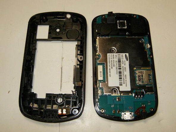

    2. Samsung Brightside Speaker Module Replacement: adım 2, 3 resimden 1. Samsung Brightside Speaker Module Replacement: adım 2, 3 resimden 2. Samsung Brightside Speaker Module Replacement: adım 2, 3 resimden 3.
      • Remove the battery
      • Remove the six Phillips screws from the back frame
      • All six screws are identical M1.5X3

    3. Samsung Brightside Speaker Module Replacement: adım 3, 3 resimden 1. Samsung Brightside Speaker Module Replacement: adım 3, 3 resimden 2. Samsung Brightside Speaker Module Replacement: adım 3, 3 resimden 3.
      • Use a plastic opening tool or similar tool to separate the top from the bottom frame. Applying slight pressure in a downwards direction will disengage the plastic clips
      • Continue to slide the tool along the slot until you feel the plastic locks disengage
      • Once all locks have released, the bottom frame can simply be removed.

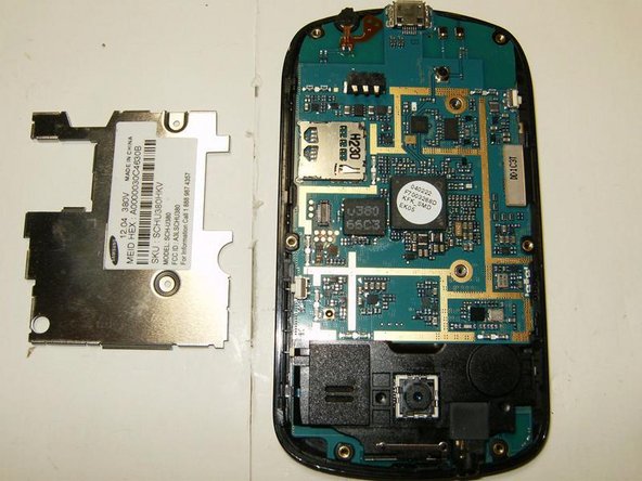

    4. Samsung Brightside Speaker Module Replacement: adım 4, 3 resimden 1. Samsung Brightside Speaker Module Replacement: adım 4, 3 resimden 2. Samsung Brightside Speaker Module Replacement: adım 4, 3 resimden 3.
      • Remove the two Phillips screws from the EMI shield.
      • Both screws are identical M1.5X2
      • Remove the EMI shield

    5. Samsung Brightside Speaker Module Replacement: adım 5, 3 resimden 1. Samsung Brightside Speaker Module Replacement: adım 5, 3 resimden 2. Samsung Brightside Speaker Module Replacement: adım 5, 3 resimden 3.
      • Detach the LCD connector.
      • Remove the logic board
      • This is the speaker module. In the center is the camera, but it is not part of the module.

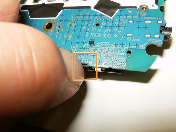

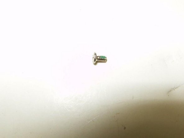

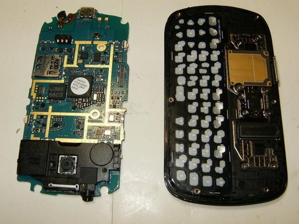

    6. Samsung Brightside Speaker Module Replacement: adım 6, 3 resimden 1. Samsung Brightside Speaker Module Replacement: adım 6, 3 resimden 2. Samsung Brightside Speaker Module Replacement: adım 6, 3 resimden 3.
      • turn the logic board over. The speaker module is held in place
      • by one Phillips screw
      • and two clips
      • Remove the Phillips screw.
      • It is a M1X2 Phillips screw
      • Next disengage one of the clips by simply applying some sideways pressure with your fingernail. This will loosen the module.

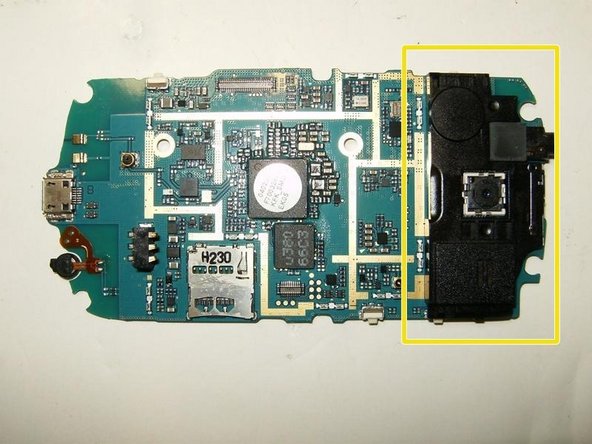

    7. Samsung Brightside Speaker Module Replacement: adım 7, 2 resimden 1. Samsung Brightside Speaker Module Replacement: adım 7, 2 resimden 2.
      • Turn the logic board around. With the speaker module loose, simply lift it off the board.
      • Speaker module removed.
      • Camera
      • and audio jack
      • are not part of this module and will remain on the board.
