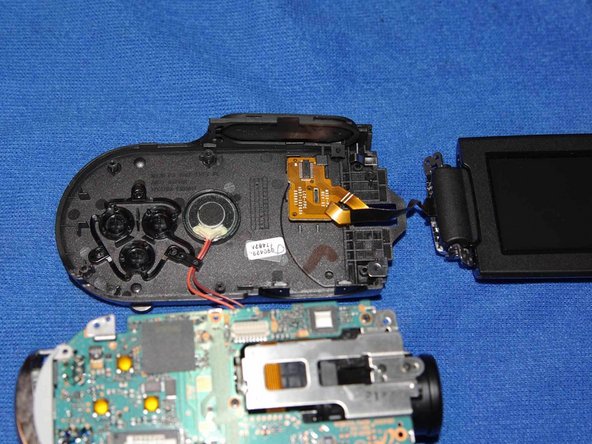

      • How to replace the LCD ribbon cable on a Samsung SMX 30F. This ribbon connects the LCD to the motherboard of the camera. For a change of LCD only the process is much simpler and only takes about ten minutes.

      • Step 1: Remove the front block.
      • Remove all the screws on the front of the camera

    3. Samsung Camera LCD Replacement: adım 3, 1 resimden 1.
      • Then gently pull on the block, be careful it is connected to the camera by rather short cables.

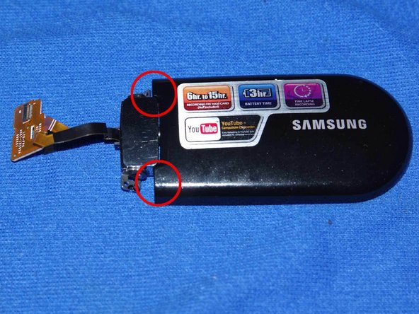

    6. Samsung Camera LCD Replacement: adım 6, 3 resimden 1. Samsung Camera LCD Replacement: adım 6, 3 resimden 2. Samsung Camera LCD Replacement: adım 6, 3 resimden 3.
      • Remove the case carefully, the cable disconnects easily from the very fragile connector.

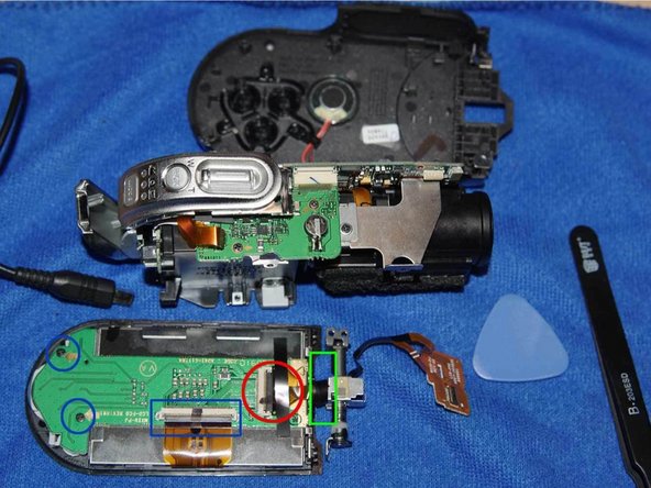

    7. Samsung Camera LCD Replacement: adım 7, 3 resimden 1. Samsung Camera LCD Replacement: adım 7, 3 resimden 2. Samsung Camera LCD Replacement: adım 7, 3 resimden 3.
      • Remove the cable from the frame.
      • Unscrew the 4 screen screws. and open it delicately using a pick.
      • Now, you can change the cable . The cable wraps around the metal axis, so make sure you count the number of rounds on disassembly to facilitate reassembly.

    8. Samsung Camera LCD Replacement: adım 8, 1 resimden 1.
      • When reassembling, first position the metal clip and the small magnet in the black housing, before putting it back on the metal shaft.
