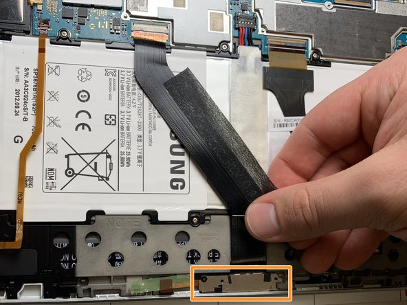

  3. Samsung Galaxy Note 10.1 Charging Port Replacement: adım 3, 3 resimden 1. Samsung Galaxy Note 10.1 Charging Port Replacement: adım 3, 3 resimden 2. Samsung Galaxy Note 10.1 Charging Port Replacement: adım 3, 3 resimden 3.
    • Remove the three 2 mm screws indicated by the red circles with the Phillips #00 screwdriver.
    • Pull the charging port indicated by the orange rectangle in picture two out from its position.
    • Unplug the black motherboard connector as indicated in the third picture.
    • Replace the charging port with a similar model.
