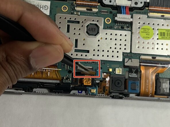

  2. Samsung Galaxy Note Pro 12.2 Front Facing Camera Replacement: adım 2, 3 resimden 1. Samsung Galaxy Note Pro 12.2 Front Facing Camera Replacement: adım 2, 3 resimden 2. Samsung Galaxy Note Pro 12.2 Front Facing Camera Replacement: adım 2, 3 resimden 3.
    Bu adımda kullanılan alet:
    • Place a spudger or an opening tool under the edge of the camera and pry straight up to disconnect it.
    • Make sure to pry under the edge of the connector itself, and not under the socket on the board. Otherwise, you risk permanently damaging the socket.
    • Work carefully: don't pry on or accidentally scrape any small, surface mounted components on the board.
    • Remove the front facing camera using the tweezers.
