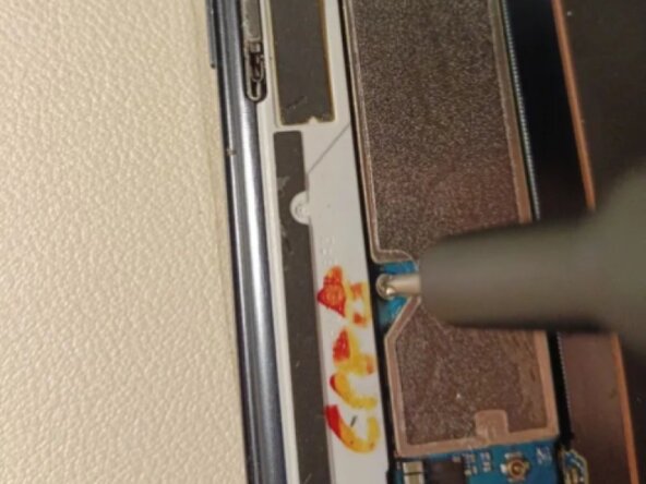

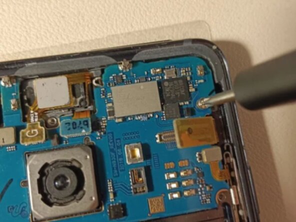

  6. Samsung Galaxy Note7 Screen Assembly Replacement: adım 6, 2 resimden 1. Samsung Galaxy Note7 Screen Assembly Replacement: adım 6, 2 resimden 2.
    • Remove the two screws holding the motherboard to the frame.

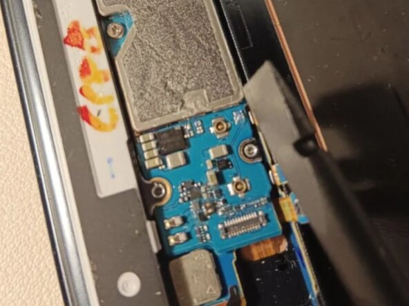

  7. Samsung Galaxy Note7 Screen Assembly Replacement: adım 7, 1 resimden 1.
    • Using a plastic spudger, lift up the bottom part of the motherboard, then lift it up and out of the frame.
