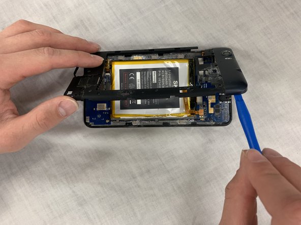

  3. Sky 6.0Q Front Camera Replacement: adım 3, 2 resimden 1. Sky 6.0Q Front Camera Replacement: adım 3, 2 resimden 2.
    • Use the plastic opening tool to help pry up the plastic backing.
    • Once loose, remove the plastic backing to expose underlying electronic components.
  4. Sky 6.0Q Front Camera Replacement: adım 4, 2 resimden 1. Sky 6.0Q Front Camera Replacement: adım 4, 2 resimden 2.
    • Disconnect the electronic adapter connecting the camera to the top mother board.
    • Once disconnected, remove the camera and replace with new camera. If necessary, use the spudger to help remove the camera.
    • To reattach front camera electrical connection, gently press piece back in place.
