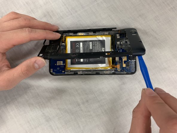

  3. Sky 6.0Q Top Motherboard Replacement: adım 3, 2 resimden 1. Sky 6.0Q Top Motherboard Replacement: adım 3, 2 resimden 2.
    • Use the plastic opening tool to help pry up the plastic backing.
    • Once loose, remove the plastic backing to expose underlying electronic components.

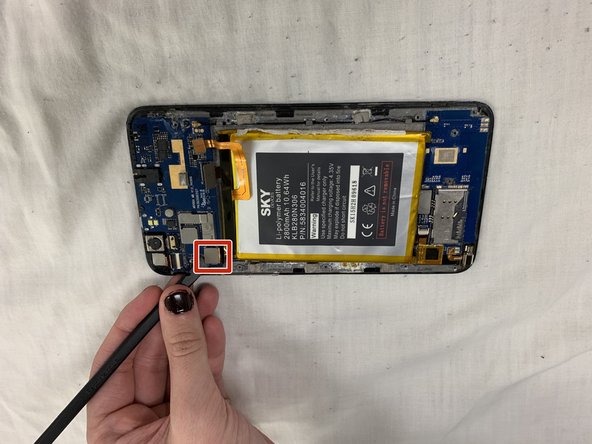

  4. Sky 6.0Q Top Motherboard Replacement: adım 4, 1 resimden 1.
    • Use the spudger disconnect the gold cord extending from the battery to the top electronic board.

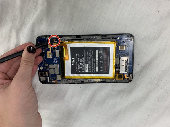

  5. Sky 6.0Q Top Motherboard Replacement: adım 5, 3 resimden 1. Sky 6.0Q Top Motherboard Replacement: adım 5, 3 resimden 2. Sky 6.0Q Top Motherboard Replacement: adım 5, 3 resimden 3.
    • Use the nylon spudger to help pry up the three top motherboard attachments.
    • See all three pictures for three attachment locations.
    • To reattach top motherboard connections gently press piece back in place.
