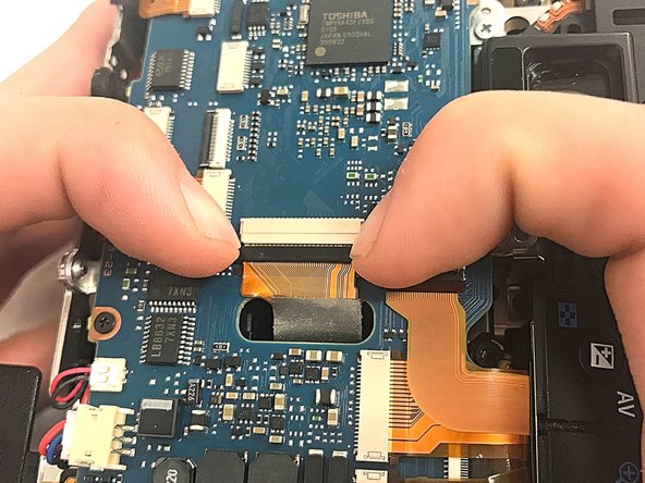

    • Remove all ribbon cables that are connected to the motherboard with a pair of tweezers or spudger by pulling them gently towards you.
  14. Sony Alpha A350 Motherboard Replacement: adım 14, 1 resimden 1.
    • Some of the ribbon cables are held in with minature clips. These cables can be identified by the side hinge that can be released with a pointed end.
  15. Sony Alpha A350 Motherboard Replacement: adım 15, 1 resimden 1.
    • Carefully pull up upward on the red and black wire ports with a pair of tweezers to remove the connections from the motherboard.
    • There are four total wire ports. two that you pull upward and two that you towards yourself.
