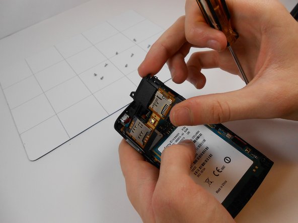

  5. Sony Ericsson Xperia X10 Camera Replacement: adım 5, 3 resimden 1. Sony Ericsson Xperia X10 Camera Replacement: adım 5, 3 resimden 2. Sony Ericsson Xperia X10 Camera Replacement: adım 5, 3 resimden 3.
    • To remove the internal case surrounding the camera, apply pressure on the left side of internal casing and using a flat head screw driver unlatch both clips on the right side of casing. Once lifted detach ribbon cable with flat head screwdriver.

  6. Sony Ericsson Xperia X10 Camera Replacement: adım 6, 2 resimden 1. Sony Ericsson Xperia X10 Camera Replacement: adım 6, 2 resimden 2.
    • Once the interior casing is removed, dislocate the hardware by unlatching clip at shown location.

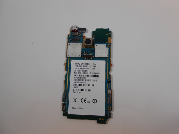

  7. Sony Ericsson Xperia X10 Camera Replacement: adım 7, 1 resimden 1.
    • To remove damaged camera flip hardware so the lens of the camera is facing downwards and remove ribbon cable connecting camera to hardware.

  8. Sony Ericsson Xperia X10 Camera Replacement: adım 8, 1 resimden 1.
    • Once camera is removed, insert new functional camera part and reassemble
