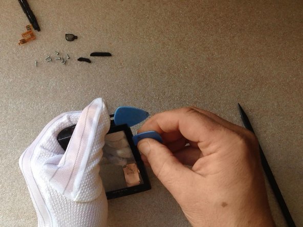

  5. Sony Ericsson Xperia X10 Touchscreen Glass Digitizer Replacement, Touchscreen Glass Digitizer: adım 5, 3 resimden 1. Sony Ericsson Xperia X10 Touchscreen Glass Digitizer Replacement, Touchscreen Glass Digitizer: adım 5, 3 resimden 2. Sony Ericsson Xperia X10 Touchscreen Glass Digitizer Replacement, Touchscreen Glass Digitizer: adım 5, 3 resimden 3.
    • Use a heat gun or a hairdryer and warm the glass.
    • With a cutter carefully make a room between the glass and the frame to insert a Plastic Pick.
    • Slowly separate the Touchscreen from the frame.
