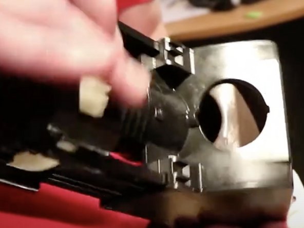

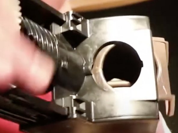

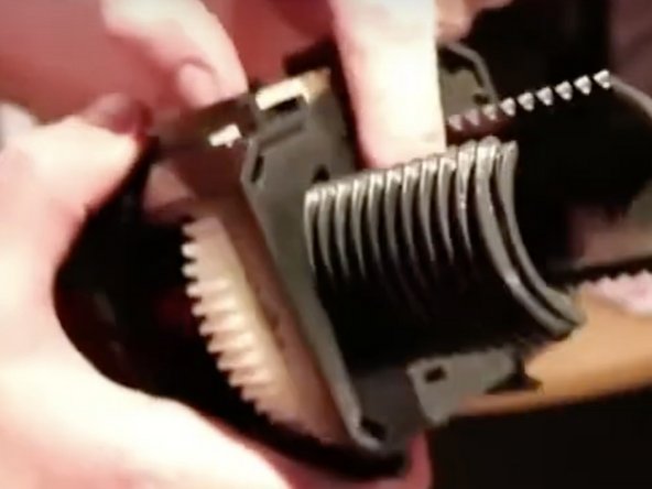

  11. Understanding the brew unit in a fully automatic coffee machine: adım 11, 3 resimden 1. Understanding the brew unit in a fully automatic coffee machine: adım 11, 3 resimden 2. Understanding the brew unit in a fully automatic coffee machine: adım 11, 3 resimden 3.
    • At the same time, the piston on the other side of the brewing unit is compressed.
    • The water is now being added where the finger is pointing in the second picture in this step.
    • And the third picture shows where the coffee will come out when it's ready.
