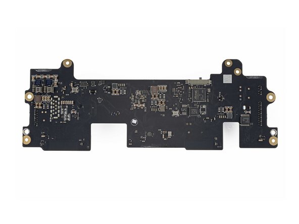

  5. Valve Index Chip ID, Headset Main Board Side 2: adım 5, 2 resimden 1. Valve Index Chip ID, Headset Main Board Side 2: adım 5, 2 resimden 2.
    • Chip ID, part 1:
    • Microchip ATSAMG55J19B-MU 32-bit ARM Cortex-M4 microcontroller w/ flash - 32 kB
    • NXP Semiconductor LPC11U14 32-bit ARM Cortex-M0 microcontroller w/ flash - 32 kB
    • Winbond W25X10CL 1 Mb serial NOR flash memory
    • Macronix MX25L512E 64 KB serial NOR flash memory
    • Goodix TFA9892 13.2 W class-D audio amplifier
    • Texas Instruments LP5562 4-ch LED driver w/ program memory
    • Texas Instruments TPS65132T6 dual output power supply
  6. Valve Index Chip ID: adım 6, 1 resimden 1.
    • Chip ID, part 2:
    • Texas Instruments TS5USBC41x USB 2.0 dual SPDT analog switch w/ overvoltage protection
    • Texas Instruments TS3USB30E USB 2.0 dual-channel SPDT analog switch
    • Texas Instruments TPS562201 2 A synchronous step-down converter
    • Texas Instruments TPS563209 3 A synchronous step-down voltage regulator
    • Toll Microelectronic TMI3255T 5 A synchronous step-down converter
    • Texas Instruments TPS259571 eFuse w/ overvoltage protection
    • Texas Instruments TPS2H000-Q1 2-ch. smart high-side power switch
  7. Valve Index Chip ID: adım 7, 1 resimden 1.
    • Chip ID, part 3:
    • Texas Instruments TPS22915C 2 A load switch
    • Texas Instruments TPS22970 4 A load switch
    • Texas Instruments TLV70728P 200 mA / 2.8 V LDO regulator
    • Nexperia 74LVC157A quad 2-input multiplexer
    • Texas Instruments TCA9803 2-bit level-translating bus buffer/repeater
    • Texas Instruments SN74AUP2G125 dual bus buffer
    • Texas Instruments SN74AVC4T245 4-bit dual-supply bus transceiver

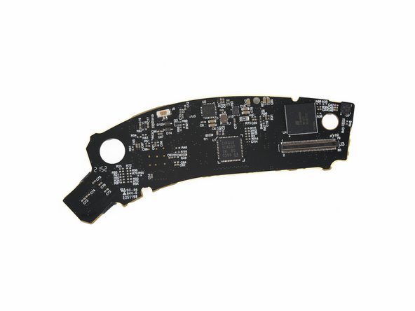

  10. Valve Index Chip ID, Left Controller Handle Board Side 1: adım 10, 2 resimden 1. Valve Index Chip ID, Left Controller Handle Board Side 1: adım 10, 2 resimden 2.
    • Chip ID, part 1:
    • Fitipower Integrated Tech FP6183-12X7 300 mA / 1.2 V LDO regulator
    • onsemi NCP161AMX330TBG 450 mA / 3.3 V LDO regulator
    • Renesas load switch (likely)

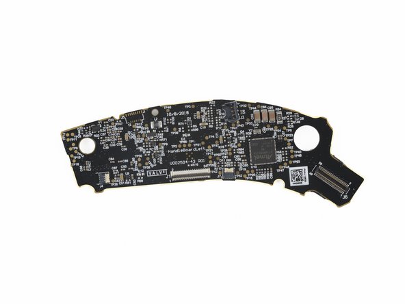

  11. Valve Index Chip ID, Left Controller Handle Board Side 2: adım 11, 2 resimden 1. Valve Index Chip ID, Left Controller Handle Board Side 2: adım 11, 2 resimden 2.
    • Chip ID, part 1:
    • Lattice Semiconductor iCE40HX8K-BG121 iCE40 HX FPGA
    • Cirque 1CA037 touch controller
    • Texas Instruments BQ24297 3 A Li-Ion battery charger
    • Texas Instruments BQ27421-G1D battery fuel gauge
    • Renesas mixed signal array
    • Texas Instruments TPS630250 2 A buck-boost converter
    • onsemi NCP161AMX300TBG 450 mA / 3.0 V LDO regulator
  12. Valve Index Chip ID: adım 12, 1 resimden 1.
    • Chip ID, part 2 - sensors:
    • TDK-InvenSense ICM-20602 6-axis MEMS accelerometer & gyroscope
