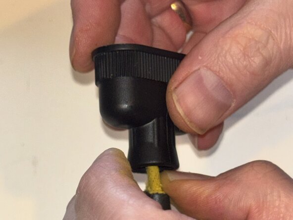

  2. Vintage Plug Replacement: adım 2, 3 resimden 1. Vintage Plug Replacement: adım 2, 3 resimden 2. Vintage Plug Replacement: adım 2, 3 resimden 3.
    • Always be careful with knives. Never point them at yourself while cutting and always fold them when finished.
    • Comparing the length of your new plug, take your cutting knife, and mark a line where the end of the plug lines up with the wire.
    • The recommended length to cut in order to properly strip the wire is about an inch and a half, and can be measured using the plug.

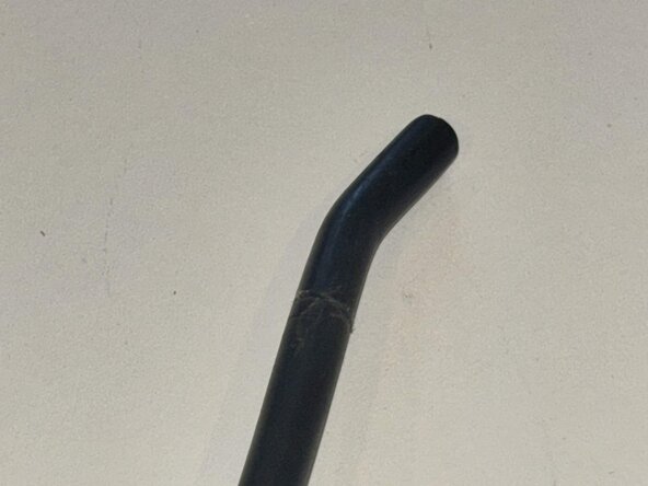

  4. Vintage Plug Replacement: adım 4, 3 resimden 1. Vintage Plug Replacement: adım 4, 3 resimden 2. Vintage Plug Replacement: adım 4, 3 resimden 3.
    • With the casing now cut open, peel it back until the inner two wires are fully exposed like in Photo 2.
    • Cut off the excess casing you have peeled back; it's not necessary anymore and will only prevent you from feeding the wire into the plug.
    • Take your wire and tighten it with your pliers if necessary, then feed it through the bottom hole of the plug. Pull down until you have enough room to move the wire around.

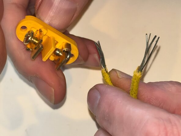

  5. Vintage Plug Replacement: adım 5, 2 resimden 1. Vintage Plug Replacement: adım 5, 2 resimden 2.
    • You may notice the casing on the end of the wires here look a lot different. This is because wires from the 70's and prior were insulted using cloth or fabric. This may make them a little more annoying to strip, so keep in mind you may need more force.
    • Take your standard wire stripper, and using the size gauge, take your wire and put it roughly about an inch into the hole, about the length of your fingernail.
    • Clamp down onto the insulation, and twist the wire before pulling upwards towards the end of the wire. The insulation will fray and eventually cut off. Your end result should resemble Picture 2.
    • Fabric insulation can be a little trickier to remove, even after stripped. You can used your knife to very carefully cut off the ends that remain attached without any damage to the wire, but be careful as this is a bit closer to your hand.
