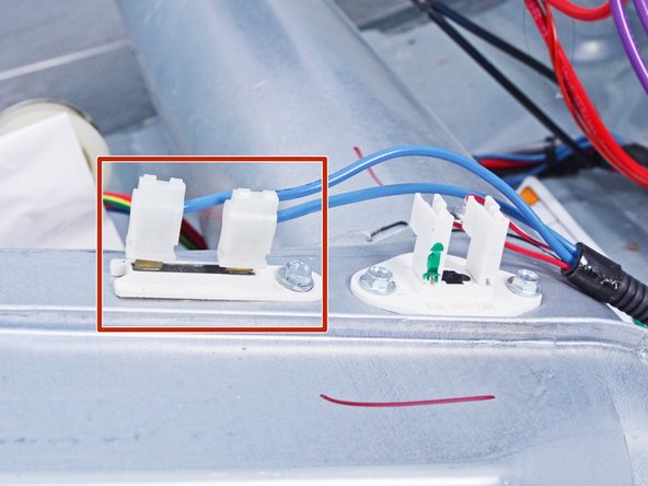

  46. Whirlpool Dryer Belt Switch Testing and Replacement, Thermal fuse location: adım 46, 2 resimden 1. Whirlpool Dryer Belt Switch Testing and Replacement, Thermal fuse location: adım 46, 2 resimden 2.
    • This step shows the thermal fuse location and appearance.

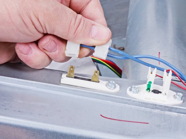

  47. Whirlpool Dryer Belt Switch Testing and Replacement, Disconnect the thermal fuse: adım 47, 3 resimden 1. Whirlpool Dryer Belt Switch Testing and Replacement, Disconnect the thermal fuse: adım 47, 3 resimden 2. Whirlpool Dryer Belt Switch Testing and Replacement, Disconnect the thermal fuse: adım 47, 3 resimden 3.
    • Disconnect the two spade connectors attached to the thermal fuse.
    • Always remove wires by pulling on the connector, not the wire.
