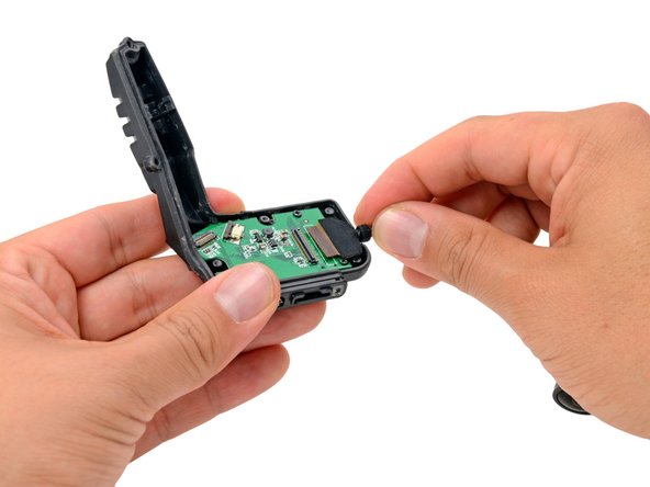

  24. Zeal Optics iON Button Board Replacement, Button Board: adım 24, 2 resimden 1. Zeal Optics iON Button Board Replacement, Button Board: adım 24, 2 resimden 2.
    • Use the tip of a spudger to flip up the retaining flap on the button board data cable ZIF connector.
    • Be sure you are prying on the hinged flap, not the socket itself.
  25. Zeal Optics iON Button Board Replacement: adım 25, 2 resimden 1. Zeal Optics iON Button Board Replacement: adım 25, 2 resimden 2.
    • Remove the button board data cable from its socket on the button board.
  26. Zeal Optics iON Button Board Replacement: adım 26, 1 resimden 1.
    • Remove the three 4.5 mm Phillips screws securing the button board to the viewfinder housing.
  27. Zeal Optics iON Button Board Replacement: adım 27, 2 resimden 1. Zeal Optics iON Button Board Replacement: adım 27, 2 resimden 2.
    • Remove the button board from the viewfinder housing.
