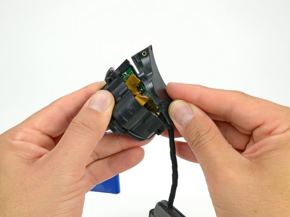

  17. Zeal Optics iON Camera Sensor Replacement, Motherboard Assembly: adım 17, 1 resimden 1.
    • Remove the following four screws securing the back cover of the camera housing:
    • two silver 8.5 mm screws,
    • two black 8.8 mm screws.

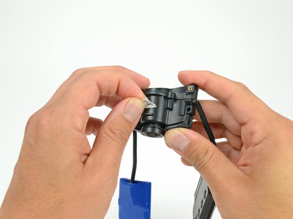

  18. Zeal Optics iON Camera Sensor Replacement: adım 18, 2 resimden 1. Zeal Optics iON Camera Sensor Replacement: adım 18, 2 resimden 2.
    • Peel the white sticker off the bottom of the camera housing.

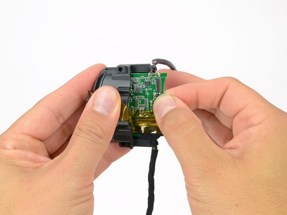

  19. Zeal Optics iON Camera Sensor Replacement: adım 19, 3 resimden 1. Zeal Optics iON Camera Sensor Replacement: adım 19, 3 resimden 2. Zeal Optics iON Camera Sensor Replacement: adım 19, 3 resimden 3.
    • Lift the back cover off the camera housing and remove it.
  20. Zeal Optics iON Camera Sensor Replacement: adım 20, 2 resimden 1. Zeal Optics iON Camera Sensor Replacement: adım 20, 2 resimden 2.
    • Use the tip of a spudger to pry up the retaining flap of the camera sensor cable ZIF connector on the motherboard.
    • Be sure that you are prying up on the hinged flap, not the connector itself.
  21. Zeal Optics iON Camera Sensor Replacement: adım 21, 2 resimden 1. Zeal Optics iON Camera Sensor Replacement: adım 21, 2 resimden 2.
    • Pull the camera sensor ribbon cable straight out of its connector on the motherboard.

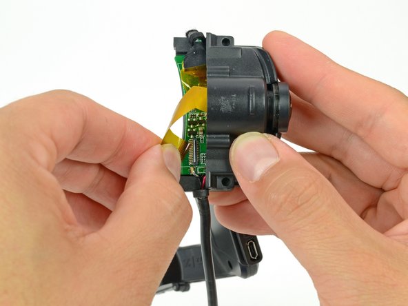

  22. Zeal Optics iON Camera Sensor Replacement: adım 22, 3 resimden 1. Zeal Optics iON Camera Sensor Replacement: adım 22, 3 resimden 2. Zeal Optics iON Camera Sensor Replacement: adım 22, 3 resimden 3.
    • Grab the edge of the motherboard and gently slide it out of the camera housing.
    • There may be some resistance due to the foam pad along the bottom of the camera housing.

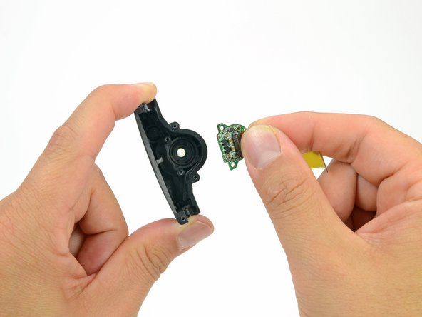

  23. Zeal Optics iON Camera Sensor Replacement, Camera Sensor: adım 23, 1 resimden 1.
    • Remove the two 9.3 mm screws securing the camera sensor board to the camera lens housing.
  24. Zeal Optics iON Camera Sensor Replacement: adım 24, 2 resimden 1. Zeal Optics iON Camera Sensor Replacement: adım 24, 2 resimden 2.
    • Grab the camera sensor ribbon cable and remove the sensor board from the camera lens housing.
