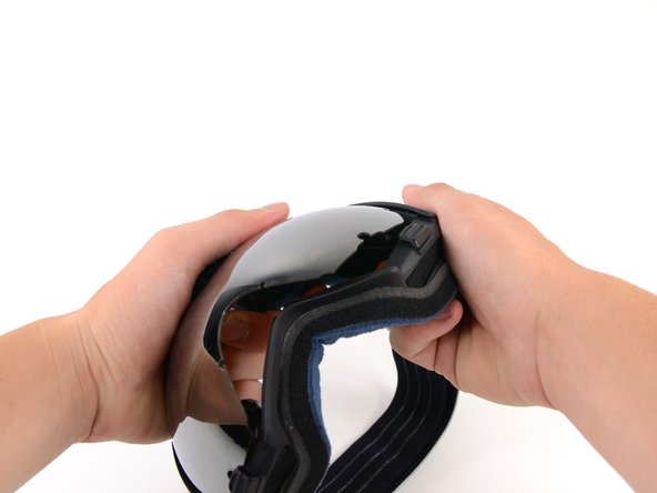

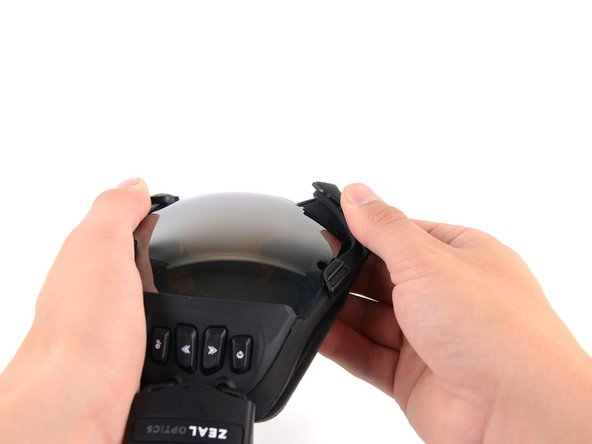

  1. Zeal Optics iON LCD Replacement, Lens: adım 1, 2 resimden 1. Zeal Optics iON LCD Replacement, Lens: adım 1, 2 resimden 2.
    • In the next few steps, you will be releasing the clips that hold the lens in place. Do not try to completely remove the lens until all the clips have been released.
    • Hold the iON in your hands with your thumbs on the clips next to the middle of the lens.
    • Pull the rubber housing apart to release the first two clips.

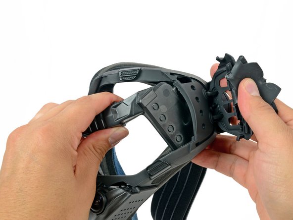

  2. Zeal Optics iON LCD Replacement: adım 2, 2 resimden 1. Zeal Optics iON LCD Replacement: adım 2, 2 resimden 2.
    • Grab the inside of the plastic nose rest with your thumb and index finger.
    • Rotate the nose rest upwards until you feel that it is free from the lens.

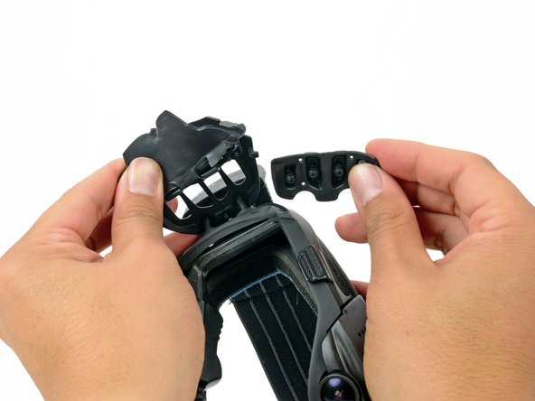

  4. Zeal Optics iON LCD Replacement: adım 4, 2 resimden 1. Zeal Optics iON LCD Replacement: adım 4, 2 resimden 2.
    • While firmly holding the goggles with the palm of one hand, grab the top right corner of the frame and rotate it away from the lens.

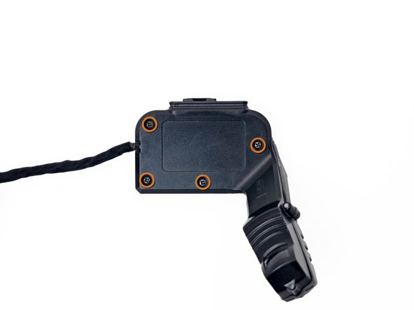

  6. Zeal Optics iON LCD Replacement, Camera Assembly: adım 6, 1 resimden 1.
    • Remove the four 7.1 mm Phillips screws securing the camera housing to the goggle frame.

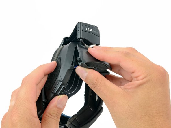

  7. Zeal Optics iON LCD Replacement: adım 7, 3 resimden 1. Zeal Optics iON LCD Replacement: adım 7, 3 resimden 2. Zeal Optics iON LCD Replacement: adım 7, 3 resimden 3.
    • Peel back the rubber battery cover from the inner left side of the frame.
    • While firmly holding the battery cover, pull the bottom of the strap mount cover up and off of the frame

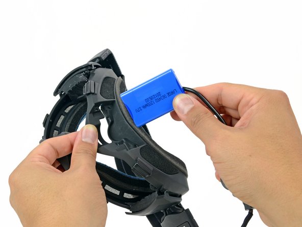

  9. Zeal Optics iON LCD Replacement: adım 9, 2 resimden 1. Zeal Optics iON LCD Replacement: adım 9, 2 resimden 2.
    • Pull the battery out of its recess in the frame.
    • The battery is connected to the entire camera assembly and cannot be completely removed by itself.

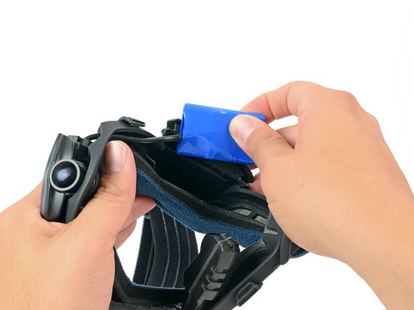

  16. Zeal Optics iON LCD Replacement: adım 16, 2 resimden 1. Zeal Optics iON LCD Replacement: adım 16, 2 resimden 2.
    • In the same manner described above, remove the battery from the frame.

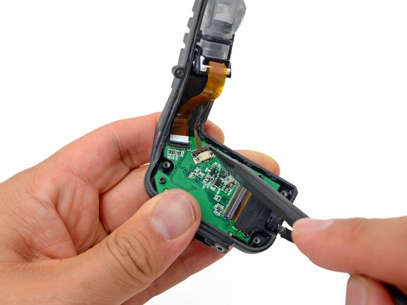

  20. Zeal Optics iON LCD Replacement: adım 20, 2 resimden 1. Zeal Optics iON LCD Replacement: adım 20, 2 resimden 2.
    • Use the tip of a spudger to push out the retaining clip on the viewfinder backlight ribbon cable ZIF connector.

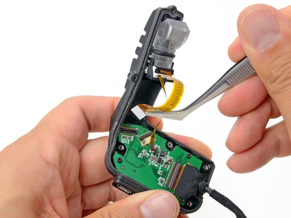

  21. Zeal Optics iON LCD Replacement: adım 21, 2 resimden 1. Zeal Optics iON LCD Replacement: adım 21, 2 resimden 2.
    Bu adımda kullanılan alet:
    • Using your fingers or tweezers, gently pull out the backlight ribbon cable from its connector on the button board.
  22. Zeal Optics iON LCD Replacement: adım 22, 2 resimden 1. Zeal Optics iON LCD Replacement: adım 22, 2 resimden 2.
    • Using your fingers or tweezers, remove the LCD ribbon cable from its connector on the button board.

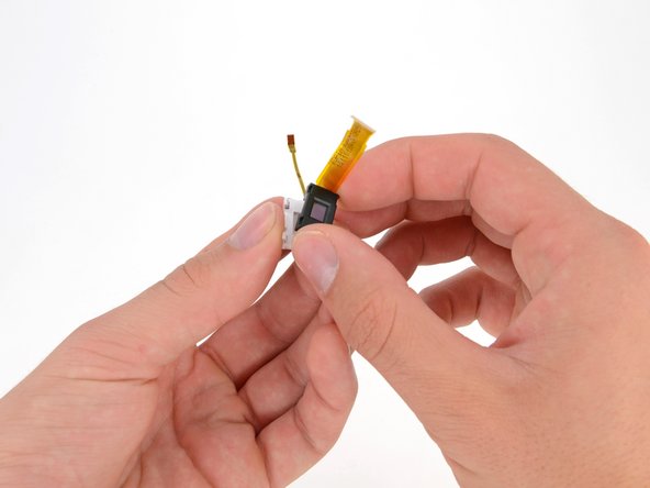

  26. Zeal Optics iON LCD Replacement: adım 26, 2 resimden 1. Zeal Optics iON LCD Replacement: adım 26, 2 resimden 2.
    • Using your thumbs, pull the four white tabs on the backlight away from the LCD panel.
    • Remove the LCD from the backlight.
