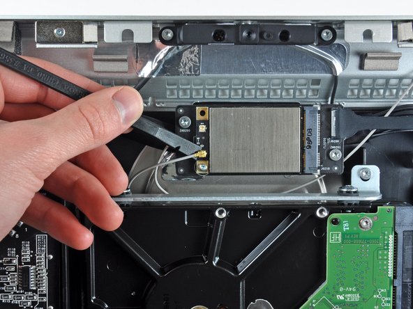

  10. iMac Intel 21.5" EMC 2308 AirPort Card Replacement, AirPort Card: adım 10, 2 resimden 1. iMac Intel 21.5" EMC 2308 AirPort Card Replacement, AirPort Card: adım 10, 2 resimden 2.
    • Use the flat end of a spudger to pry both AirPort antenna cable connectors up off the AirPort card.
  11. iMac Intel 21.5" EMC 2308 AirPort Card Replacement: adım 11, 1 resimden 1.
    • Remove the single 5.3 mm T6 Torx screw securing the AirPort card to its socket.
  12. iMac Intel 21.5" EMC 2308 AirPort Card Replacement: adım 12, 1 resimden 1.
    • Pull the AirPort card away from its socket and remove it from the iMac.
