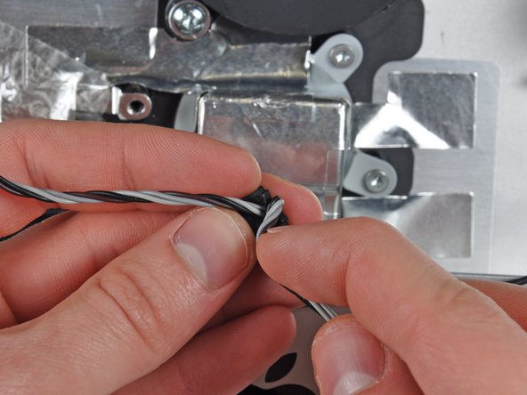

    • De-route the left speaker cable from the clips securing it to the outer case.
  39. iMac Intel 21.5" EMC 2308 Left Speaker Replacement: adım 39, 2 resimden 1. iMac Intel 21.5" EMC 2308 Left Speaker Replacement: adım 39, 2 resimden 2.
    • Carefully remove the left speaker and ambient temperature sensor cables from the CPU fan cable retainer.
