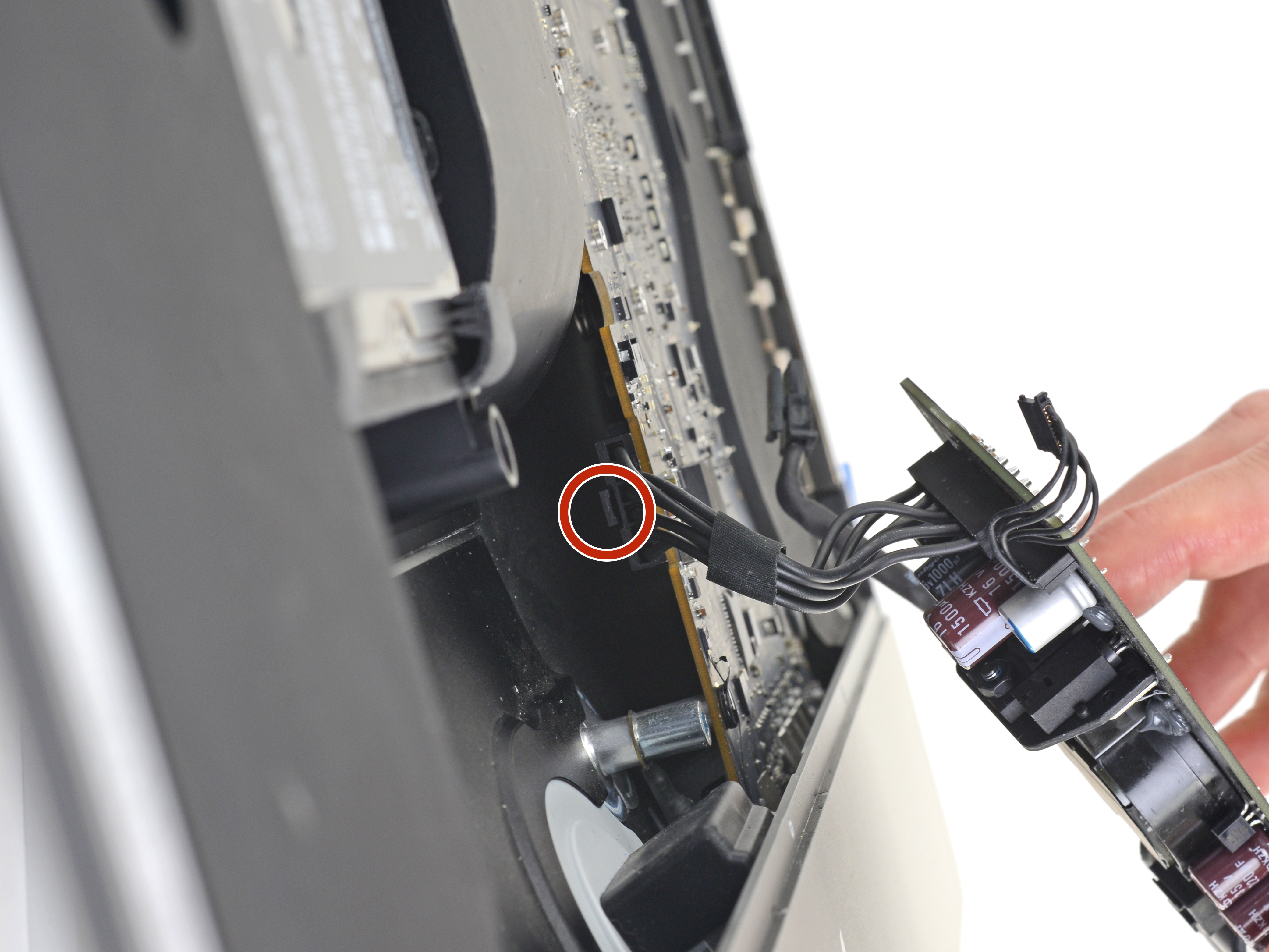

    8. iMac Intel 21.5" EMC 3068 RAM Replacement: adım 35, 3 resimden 1. iMac Intel 21.5" EMC 3068 RAM Replacement: adım 35, 3 resimden 2. iMac Intel 21.5" EMC 3068 RAM Replacement: adım 35, 3 resimden 3.
      • Be very careful not to touch the capacitor leads or any exposed solder joints on the back of the power supply. Only handle the board by the edges.
      • Do not let any of the exposed solder joints come in contact with a metal surface, as that can cause a short.
      • Flip the power supply over to access the DC power cable connection behind the logic board.
      • To disconnect the cable, squeeze the release clip on the back side of the connector, behind the logic board, and pull the connector straight out.

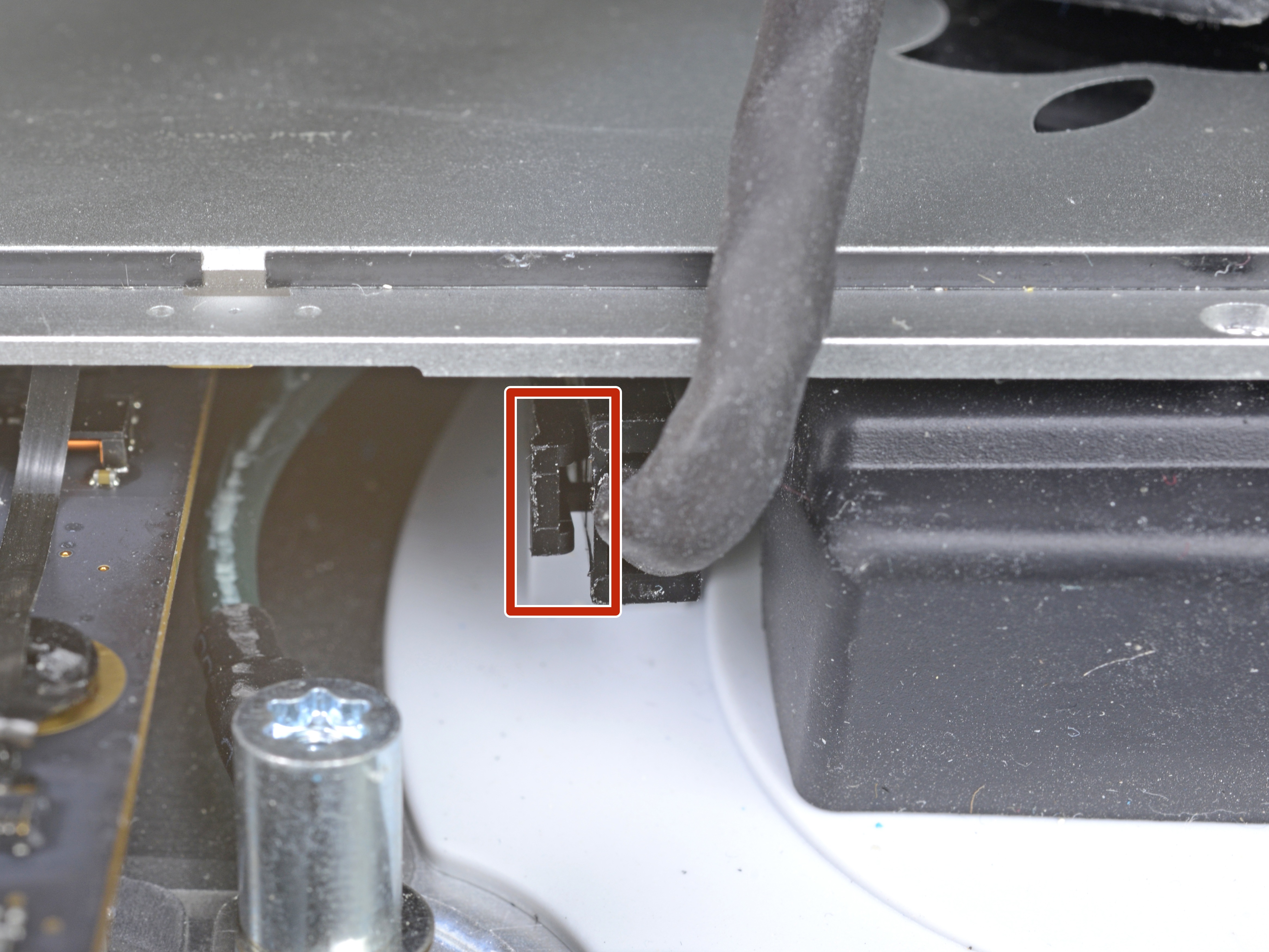

      • You may find it helpful to set the iMac down on its back for the next couple of steps.
      • Use the flat end of a spudger to press the release clip on the side of the AC inlet cable connector inward.
      • While pressing on the release clip with the spudger, grasp the AC inlet cable, and pull the connector straight out of its socket.
      FixBot'a Sor
      Yorum Ekle
    10. iMac Intel 21.5" EMC 3068 RAM Replacement: adım 37, 1 resimden 1.
      • Remove the power supply from the iMac.
