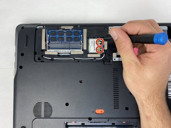

Adım 4
Gateway NE56R27u Motherboard Replacement: adım 0, 3 resimden 1. Gateway NE56R27u Motherboard Replacement: adım 0, 3 resimden 2. Gateway NE56R27u Motherboard Replacement: adım 0, 3 resimden 3.
  • Using the hook end of a halberd spudger, gently pry up the black and white wires from the wireless card.
