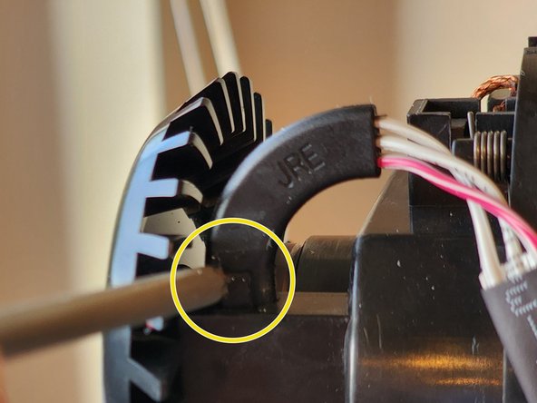

Commercial 8 Quart Bowl-Lift Stand Mixer - Powertrain/Motor Replacement, Remove the hall effect sensor and powertrain/motor: adım 0, 2 resimden 1. Commercial 8 Quart Bowl-Lift Stand Mixer - Powertrain/Motor Replacement, Remove the hall effect sensor and powertrain/motor: adım 0, 2 resimden 2.
  • Remove the hall effect sensor from its mount by pressing down on the tab indicated in the first picture and sliding it out.
  • Now that the powertrain/motor is fully disconnected from the mixer, remove it and place it to the side.
  • Begin the reassembly process with the new powertrain/motor
