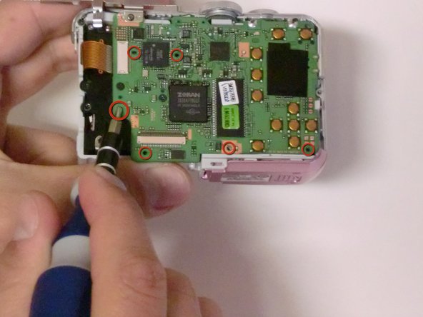

  • Using a #00 Philips screwdriver, remove the three 3.32 mm screws connecting the logic board to the camera.
  • Separate the logic board and the core of the camera.
