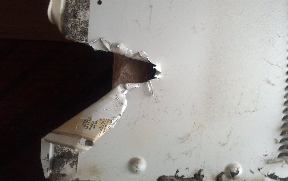

Thanks for the support so far. Working on removing the metal frame the air conditioner was housed in this morning. At first nice and quietly with the bolt cutters as not to disturb the neighborhood. Then, more successfully using the angle grinder to cut away the box.

The base of the AC unit was resting on the roof below. Some tar was keeping it in place. I used a crowbar aka "Sparticus" to pry up the final pieces.

Jacob, great demolishing job:-)! anyhow, at this time you will have to repair the brick work in the opening. Use what looks like a top beam in your pictures as the lentil. Get some pressure treated lumber and fasten it with anchor bolts around the window opening. That will give you something to mount the new window to. I would check sites like this for installation instruction. Of course, not knowing where you live, you also want to make sure that you have proper drainage away from the window etc. Follow your local building code. It is a relatively small opening, so keep the framing reasonable. The attached images shows how it should be done:-)Hope this helps, good luck.
