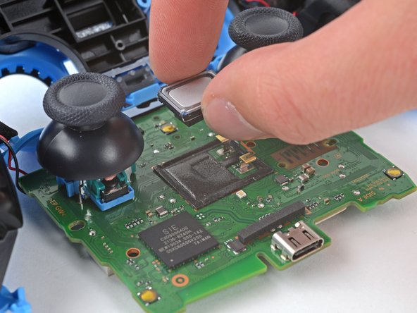

  25. DualSense Controller v2 Speaker Replacement, Lift out the motherboard: adım 25, 3 resimden 1. DualSense Controller v2 Speaker Replacement, Lift out the motherboard: adım 25, 3 resimden 2. DualSense Controller v2 Speaker Replacement, Lift out the motherboard: adım 25, 3 resimden 3.
    • Carefully guide the joysticks through the front case and lift the motherboard out.
    • Don't strain the four soldered wires tethering the motherboard to the vibration motors.

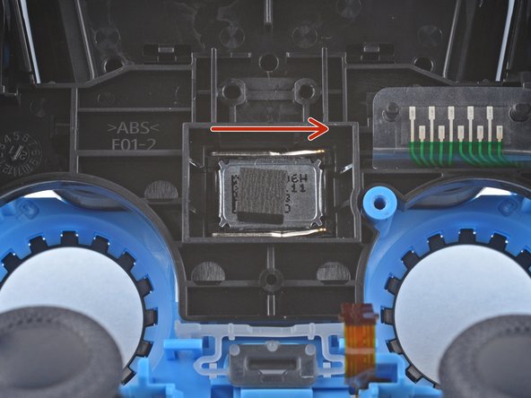

  26. DualSense Controller v2 Speaker Replacement, Remove the speaker: adım 26, 3 resimden 1. DualSense Controller v2 Speaker Replacement, Remove the speaker: adım 26, 3 resimden 2. DualSense Controller v2 Speaker Replacement, Remove the speaker: adım 26, 3 resimden 3.
    • Gently lift the speaker off of the motherboard.
    • The speaker is secured to the motherboard by some light foam adhesive. Don't remove this foam.
    • During reassembly, place the speaker into the midframe with the gold contacts pointing towards the left joystick.
