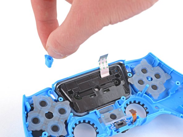

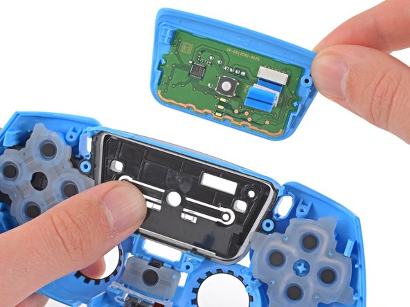

  29. DualSense Controller v2 Touchpad Replacement, Remove the touchpad: adım 29, 1 resimden 1.
    • Use your Phillips screwdriver to remove the 6.5 mm screw securing the touchpad to its bracket.
  30. DualSense Controller v2 Touchpad Replacement: adım 30, 3 resimden 1. DualSense Controller v2 Touchpad Replacement: adım 30, 3 resimden 2. DualSense Controller v2 Touchpad Replacement: adım 30, 3 resimden 3.
    • Remove the Select and Start buttons from the front case.
  31. DualSense Controller v2 Touchpad Replacement: adım 31, 3 resimden 1. DualSense Controller v2 Touchpad Replacement: adım 31, 3 resimden 2. DualSense Controller v2 Touchpad Replacement: adım 31, 3 resimden 3.
    • Grip the top right corner of the touchpad (near where the screw was) and gently pry it off of its bracket.
    • The touchpad is lightly secured to its bracket by clips.
    • Hold the bracket in place with your thumb as you separate the touchpad.
    • During reinstallation, make sure the touchpad clips engage with the bracket. You should hear and feel a snap when installed properly.
