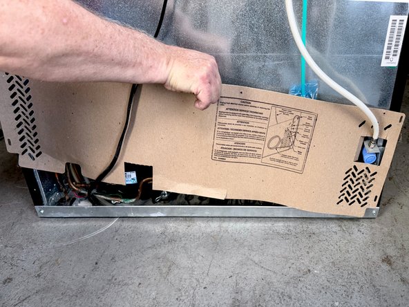

  2. Frigidaire Side-By-Side Refrigerator Condenser Inspection and Cleaning, Unfasten the rear cover: adım 2, 1 resimden 1.
    • Use a 1/4" nut driver to remove the four screws securing the rear cover to the refrigerator.
  3. Frigidaire Side-By-Side Refrigerator Condenser Inspection and Cleaning, Lift up the rear cover: adım 3, 3 resimden 1. Frigidaire Side-By-Side Refrigerator Condenser Inspection and Cleaning, Lift up the rear cover: adım 3, 3 resimden 2. Frigidaire Side-By-Side Refrigerator Condenser Inspection and Cleaning, Lift up the rear cover: adım 3, 3 resimden 3.
    • Lift the rear cover until it is free of the tabs.
    • If your water supply line is in use, turn the supply valve off, and disconnect it at the connection on the refrigerator.
    • If the water supply hose is not used, pass it through the hole in the cover.
  4. Frigidaire Side-By-Side Refrigerator Condenser Inspection and Cleaning, Remove the cover: adım 4, 1 resimden 1.
    • Remove the cover and set it aside.

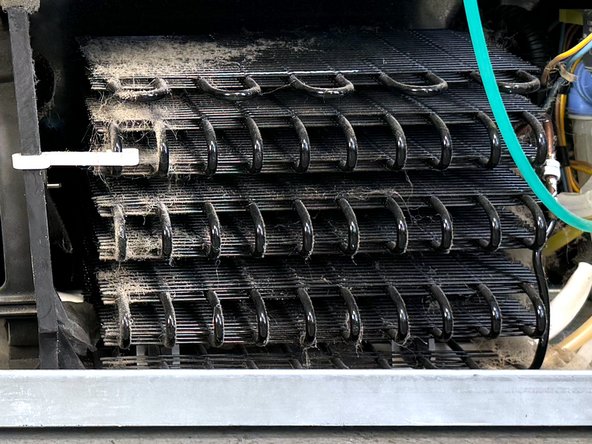

  5. Frigidaire Side-By-Side Refrigerator Condenser Inspection and Cleaning, Clean and inspect the condenser.: adım 5, 2 resimden 1. Frigidaire Side-By-Side Refrigerator Condenser Inspection and Cleaning, Clean and inspect the condenser.: adım 5, 2 resimden 2.
    • Use a soft brush to clean the condenser coils.
    • A vacuum cleaner with a hose can also be used alone or in combination with the brush for cleaning.
    • Look for oily spots on the condenser coils, often dust will stick in those places. This can be a sign of a refrigerant leak.
