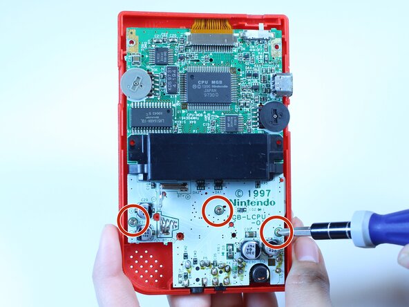

  3. Game Boy Pocket LCD Screen Replacement, Remove the motherboard screws: adım 3, 1 resimden 1.
    • Use a Phillips #1 screwdriver and turn counterclockwise to remove the three screws on the motherboard.
