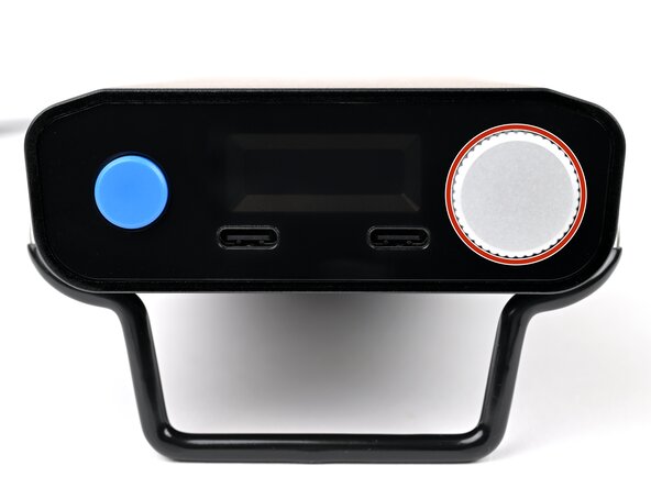

    5. How to Use the FixHub Web Console, Firmware update using the bootloader: adım 5, 3 resimden 1. How to Use the FixHub Web Console, Firmware update using the bootloader: adım 5, 3 resimden 2. How to Use the FixHub Web Console, Firmware update using the bootloader: adım 5, 3 resimden 3.
      • Follow this step to update a drained power station's firmware using the bootloader.
      • Unplug the power station from the computer.
      • Press and hold the adjustment knob.
      • Plug the power station back into to the computer, then release the adjustment knob.
      • The web console will show that the device has failed to start up.
      • Use the web console to manually update the firmware.
