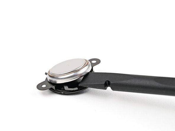

  11. Mac mini (2024) CMOS Battery Replacement, Separate the CMOS battery: adım 11, 3 resimden 1. Mac mini (2024) CMOS Battery Replacement, Separate the CMOS battery: adım 11, 3 resimden 2. Mac mini (2024) CMOS Battery Replacement, Separate the CMOS battery: adım 11, 3 resimden 3.
    • Use the flat end of a spudger, or your fingernail, to lift the CMOS battery out of its housing.
    • During reassembly, place the flat, shinier side of the battery into the section of the housing with the plus sign.
