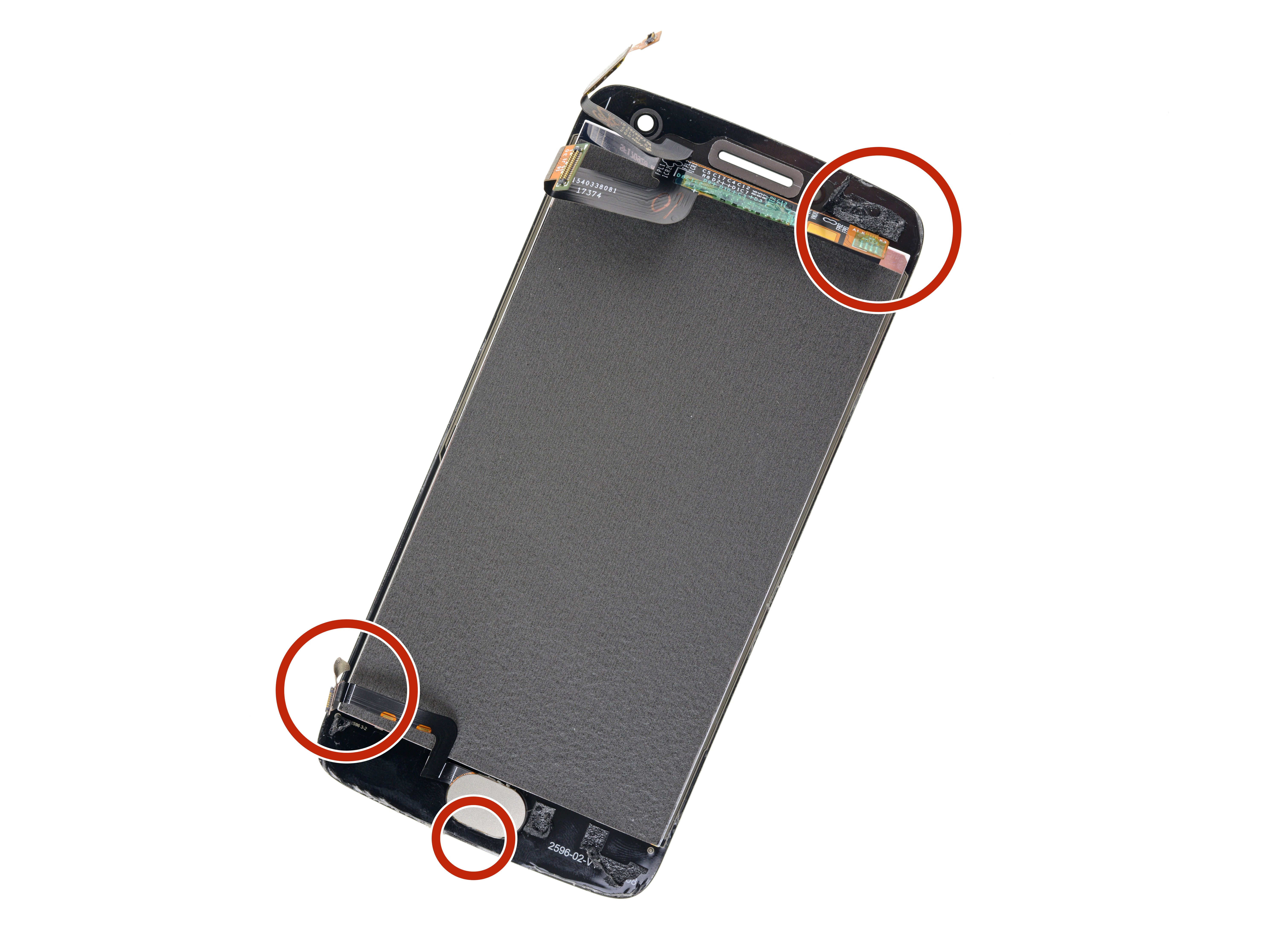

  6. Motorola Moto G5 Plus Display Assembly Replacement: adım 6, 2 resimden 1. Motorola Moto G5 Plus Display Assembly Replacement: adım 6, 2 resimden 2.
    • Slide the opening pick down and cut the adhesive around the bottom of the display.
    • If the adhesive is too tough to cut, continue to heat it until it softens enough to cut fairly easily. Excessive prying or force used here could permanently damage the display or other components.
    • Be careful as you slide your pick around the top and bottom edges of the display. The display cables, fingerprint sensor, and fingerprint sensor cable are all housed fairly close to the edge of the display and can easily be damaged. Refer to this image to see the exact location of the cables.
