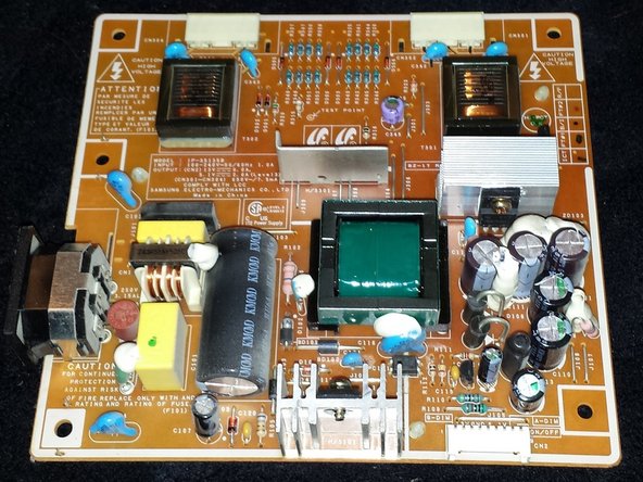

  1. Samsung 930 LCD Monitor Power Board Replacement, Power Board: adım 1, 1 resimden 1.
    • You will need a phillips screwdriver and a replacement power board which can be ordered online 1. First, place the monitor face down, then remove the plastic covering if it’s on Once this is done remove the three screws shown below. Once these screws are removed, the stand is able to be removed.

    • 7. Now the metal casing that is holding the power board can be detached from the LCD screen. You’ll need to remove the final three screws in order to replace the power board. You’ll be able to follow this walkthrough in reverse in order to reassemble the monitor.
