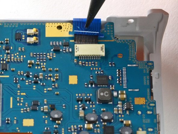

  20. Samsung NX Mini Motherboard Replacement: adım 20, 3 resimden 1. Samsung NX Mini Motherboard Replacement: adım 20, 3 resimden 2. Samsung NX Mini Motherboard Replacement: adım 20, 3 resimden 3.
    • Disconnect the blue ribbon cable from the motherboard.
    • Insert the pointed end of a spudger into the hole in the top of the ribbon.
    • Gently pull the ribbon from the connector.
