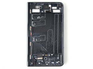

+ | [title] Reassembly information |
+ | [* icon_reminder] During reassembly, perform the following: |
+ | [* black] Use tweezers or your fingers to peel and remove the old adhesive from the frame. |
+ | [* black] If any residue remains, apply a few drops of highly-concentrated isopropyl alcohol (over 90%) to the frame and wipe it with a lint-free or microfiber cloth. |
